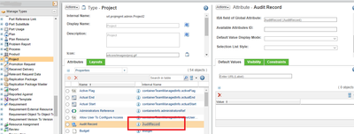

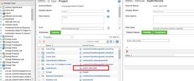

The internal name of an attribute can be changed with a simple database edit.
In the example below the original internal name, AuditRecord, has been changed to AUDIT_RECORD
NOTE: Windchill restart after the database edit is required to take affect.
Before
After

What table is the information stored in?
 Another option for you could be to use PTCs attribute utility, create a new attribute and the utility can move the old attribute onto it, effectively renaming it and keeping the old one which you can delete later. Seems less risky, there’s definitely some attribute internal names which would cause major failures if they were just changed.
http://support.ptc.com/help/windchill/wc110_hc/whc_en/#page/Windchill_Help_Center%2FTypeAttrChp_MoveUtility.html%23
