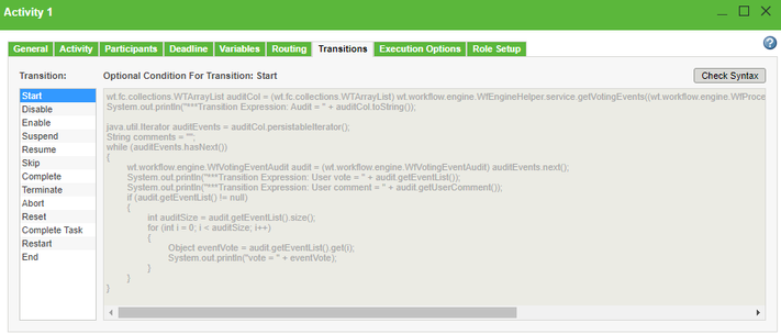

It depends where you want to run the code. Task or Workflow.
here is example how I get the vote from in the workflow task when the task starts.
I use it for showing comments from the previous tasks
wt.fc.collections.WTArrayList auditCol = (wt.fc.collections.WTArrayList) wt.workflow.engine.WfEngineHelper.service.getVotingEvents((wt.workflow.engine.WfProcess) ((wt.workflow.work.WfAssignedActivity) self.getObject()).getParentProcess(), null, null, null);
System.out.println("***Transition Expression: Audit = " + auditCol.toString());
java.util.Iterator auditEvents = auditCol.persistableIterator();
String comments = "";
while (auditEvents.hasNext())
	wt.workflow.engine.WfVotingEventAudit audit = (wt.workflow.engine.WfVotingEventAudit) auditEvents.next();
	System.out.println("***Transition Expression: User vote = " + audit.getEventList());
	System.out.println("***Transition Expression: User comment = " + audit.getUserComment());
	if (audit.getEventList() != null)
		int auditSize = audit.getEventList().size();
		for (int i = 0; i < auditSize; i++)
			Object eventVote = audit.getEventList().get(i);
			System.out.println("vote = " + eventVote);
for your needs you can start the code on the Complete Task transition.
