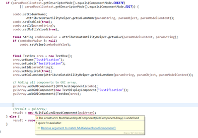

Tried doing that. Below is the snapshot of the code.

Hi @MP_10433217
If you use GuiComponentArray why do you try to create new Multivalue component?
What about just try to return the GUIComponentArray instead of using the new Multivalue method?
here is an class example where you can find how to use the GUIComponentArray
com.ptc.windchill.enterprise.attachments.dataUtilities.PrimaryAttachmentPropertiesDataUtility
PetrH
I need MultiValuedInputComponent because I want to provide input like shown below. Want Plus sign and minus for both the components at the same time.
