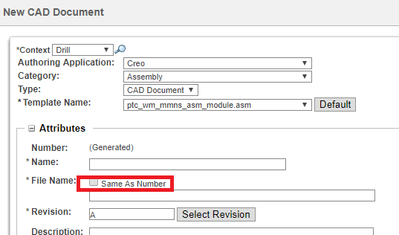

Is the preference below set to No?
Synchronize CAD File Name with CAD Document Number
No
I'm not sure if this preference is a two-way street or not but if it is having it set to Yes might create the behavior you're seeing.
David
Hi David, I have tried that preference but it doesnt make any difference, I think that preference changes the default behaviour of the checkbox when creating a new CAD document in workspace. Thanks though.

Yes you right @khimani_mohiki ..
That preference just check/uncheck the checkbox in the creation wizard as default.
