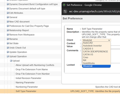

Your non-Creo data needs to have the "UPLOAD_SOFT_TYPE" variable set. You set it by CAD application in Preferences. (CS41665 )
You can then create individual EPMDocument sub-types to match your authoring applications (instructions here).
In my example, I did this for NX.
Once you have those, you create OIRs against those subtypes specifically with the OIR syntax:
  • <AttributeValues objType="wt.epm.EPMDocument|<your subtype name here>">
And in the OIRs you can then specify the folder like @mfadil suggested (CS21487).
