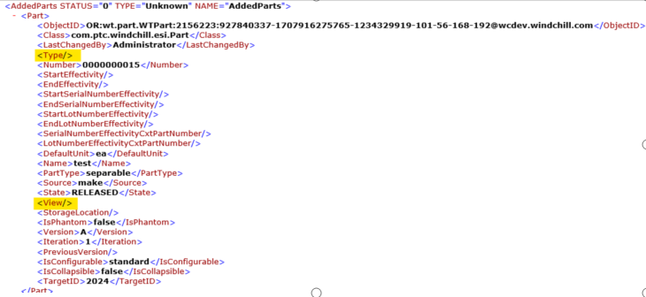

I am using Windchill Enterprise Systems Integration Release 11.1 and Datecode with CPS M020 CPS29
I added the tag called "Type" in the copy of ESIMetaResponseInfo.xml file and releasing the part through change process, I got the generated response xml file while validating the tag "Type" value showing empty and view value is also showing empty but the two attributes field having a value but in generated XML values showing empty
PFA for the reference image

How top get the values under that tags
