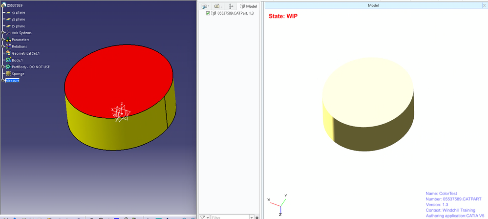

I am not Catia person, but I managed to create a simple cylinder and assign colour to every "face" (the bottom, invisible one, is blue).
I noticed there are options to assign colours on many levels, and I tried assign different colour on each of them, but the colour you can see on the righthand side in the Creo View was not among them.
We actually need to make this "colour coding" working for Creo and NX too, I just started with Catia as I am expecting it to be the most difficult one. 🙂
Color testColor test

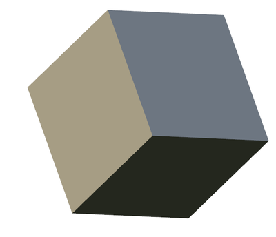

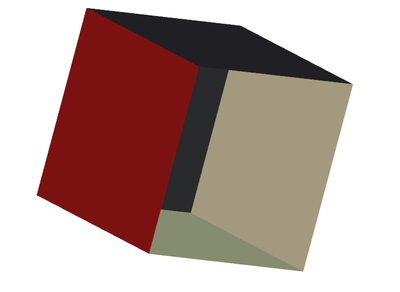

ok, I made my own test as well.
and here is how it appeared in Creo view.
Now these were material appearences, one with transparency. Seems like differences I am seeing is in lighting but I would say that it respected my intentions. There is a lighting option in Creo View.

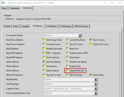

I managed to make several tests and I think I have a breakthrough in Catia.
It was trial and error, but it seems the problem is that Face Colours are overridden by a Material.
I think it makes sense and the metallic shading, in the screenshot I sent earlier, supports my theory.
When I unticked the Material Render in the RCP file it seems to be displaying all right:
