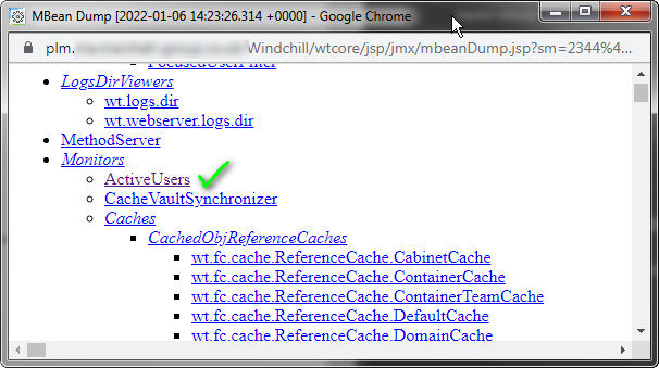

Curiosity question for today, is there a simple way to identify the method server a user is connected to? I haven't had a hung MS in a bit, but its always tricky to diagnose who's still connecting to a hung MS before its shutdown.
We run 4 MS on the production server and it would be nice to display the MS ID next to the username in the WC header.

The Server Status page in Site, Utilities
Clicking on the method server in question will produce an MBeans dump which includes a list of the active users under Monitors, Active users.
I'm not sure whether the MBeans dumb will work when the Method Sever is hanging, if you can access the server then maybe view the MBean in your Java Monitoring and Management Console, like windchill wt.util.jmx.SMJconsole
The server status page also shows a star next to host, server manager and method server you are connected to at the time.

That's true, but only site admin users have access to the status page.
If you need identify a normal user it is more complicated.
