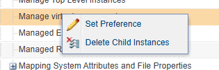

If you change a site preference or org preference, always check the lower level preferences if they are not changed to the site one.
If you really want to propagate site change from preference use the delete child instances function to reset all lower level settings from up (site)to down(user)
