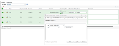

Use Case: I have to do a mass update of the "Default Trace Code" attribut that is located on the Part Master.
Description:
typically use the LodFromFile utility to update attributes on WTParts and WTDocuments. To do this, I first create a CSV file following the format outlined in [Windchill_Home]/loadFiles/csvmapfile.txt. I then convert the CSV file into an XML file using the csv2xml utility.
Currently, I need to update the "Default Trace Code" attribute across multiple parts. However, I haven't found any documentation or guidance on how to create a suitable loader for Part Master attributes.2025-09-29_15-31-05.jpg

If not too many, this can be done via edit multiple object in a search results. Even thought this is master attributes, it will check out and check in the item, but you can edit master attribute, I believe. If that works, you can do these in batches very quickly. How many parts do you need to update?

Edit Multiple Objects does not work for the Part Master attributes. 😔

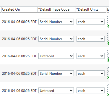

Are you sure? I just did it. You might need to update your columns and view in the edit screen to show these attributes.

Yes you can set that attribute in bulk starting  11.2,

Thanks, Fadel — yes, I can see it now. The only challenge is that many of those parts have undergone numerous revisions, so the update process will be time-consuming. I'll also need to take the production servers offline during the update. That said, it's definitely an effective solution for updating multiple items across a set of parts.
You would only need to iterate the latest version. Since you are changing a master level attribute, it should be impact all versions. Not sure you need to take the system offline to do this. Depending on your system size, it could be considered a large transaction. I would have no issue doing these updates as part of a day's work.  I would just setup a report with a counter as a a burn down list. So long as you are making process to make updates to all impact parts, burn that number to 0. Unless, you have a related process change you want to implement inconcert with the field change, users would only notice a slight delay as it does your update batch.
