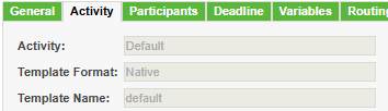

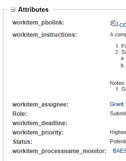

Internal display names on Workflow Tasks
LG_10096154
Version: Windchill 12.1
I am using:
How do I change to Activity to not show these internal names when using Chrome. With my Amin account in Edge the tasks display correctly.
5 REPLIES 5
Clearing browser cache in each results in what?
LG_10096154
(To:avillanueva)
Nothing, But if I switch to Edge with my normal user account it looks correct. It seems that Chrome may be causing issues again.

Hi @LG_10096154
Interesting thing is that the Edge is a chrome cored application so there should not be a difference.
Or you use internet explorer configuration and it can be the case.
btw there is no reason why one browser shows the display names and an another internal names.
I would delete all caches of the browser as @avillanueva has mentioned. All history from the beginning of being 😄
PetrH
Dumb question, but could it be a region thing..? I think the display names can be region-specific. So theoretically your admin account may be using a region that you configured, and a different account might be using a region that you didn't.
HelesicPetr
(To:joe_morton)
Hi @joe_morton
You could be right. If the region is not set then it can behave a weird way
PetrH
