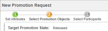

We have added a new lifecycle state which is optional for a promotion request. I have run the lifecycle upgrade utility and the parts are all showing they have the new state available. I have modified the ACLs to allow the members access to the new state. I did this first on my Windchill 12.0.2.10 test system then made the same changes to the production 11.1 M020 CPS20 system. The WIndchill 12 system is an upgrade from the Windchill 11.1 system, so it has the same base data, just a few weeks out-of-date.

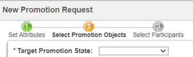

With the 12.0 system, when I do a New Promotion Request, I get a window at the top of the screen asking me to set the promotion request state.
On the Windchill 11.1 system, I only get the old Released state, no option.
I have compared the Lifecycle states and the ACLs and they are identical on both systems.
Is there something that needs done so the Windchill 11.1 system will act the same as the Windchill 12 system?

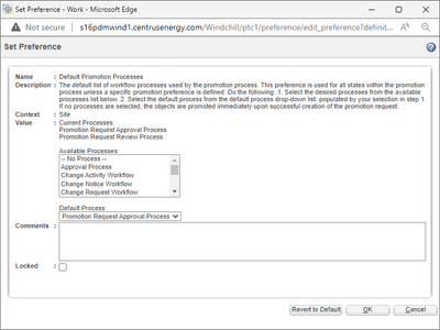

How about the preferences at the site level for Promotion Process? Are they the same?
BenLoosli
(To:avillanueva)
Both are the same setting. The Windchill 12 system is an upgrade from the data of the Windchill 11.1 system and I have not touched any settings at the site level.

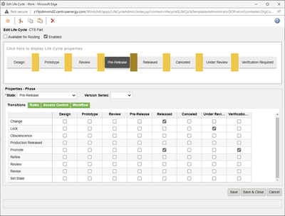

What state are you promoting from? is it the same in both systems?
Share the screenshot of the lifecycle on both WC 11 and WC 12 with the promoted from state selected in the lifecycle editor

I posted my screen shot of the Lifecycles earlier in this thread. Both Design and Pre-Release state show Verification Required as an state for Promote.
I also showed the Promotion Request screen for 11.1, showing on Target state option, and 12.o showing the Target State option drop-down.
I have tested it on the same part in both systems. The 12 system will take multiple promotion states as an option.

The lifecycle screen shots are Windchill 11.1, but the Windchill 12 look identical.
I captured in a Word document all of the Windchill 12 lifecycle state views and compared them to the WIndchill 11.1 views and all states are identical as to what is allowed.
I did the same with the ACL's for every state, also identical between the 11.1 and 12.0 systems.
