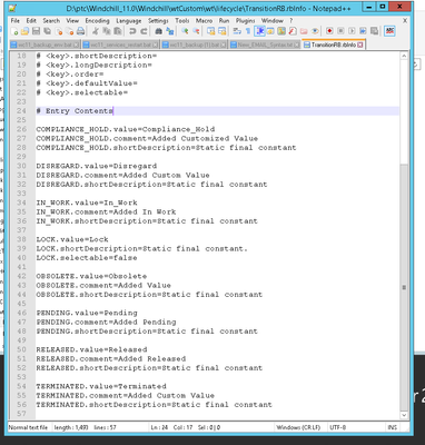

I have done everything accept I can find where the " transaction.rbinfo"  is located.  In the EnumCustomize I don't see this .
Where is this located.  I know it must be under lifecycle but not sure.  TrasitionRB.RB.ser.  Thats all I see.  If that is it then I have customized this and still does not give me the pull down.  Call me at 262-560-3217.

Hi Petar,
I found my TransitionRB.rbinfo file.
It looks like this:

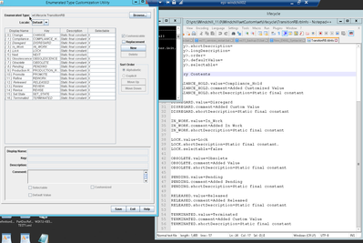

wharaden1
6-Contributor
(To:wharaden1)
Here is what my EnumCustomize looks like:
Don't these have to equal or if you have some instruction on what to change please.
Ty

If you edit a rbinfo file you need to run ant makejar script after a save in the enumcustomization wizard .
makejar propagates changes to the Windchill.

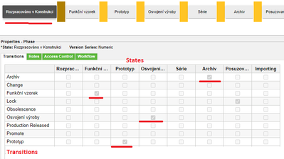

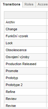

After that you should see the transitions in a LifeCycle editor

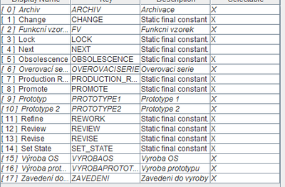

enumcustomization editor
wt.properties (used internal name)
LifeCycle editor with transitions

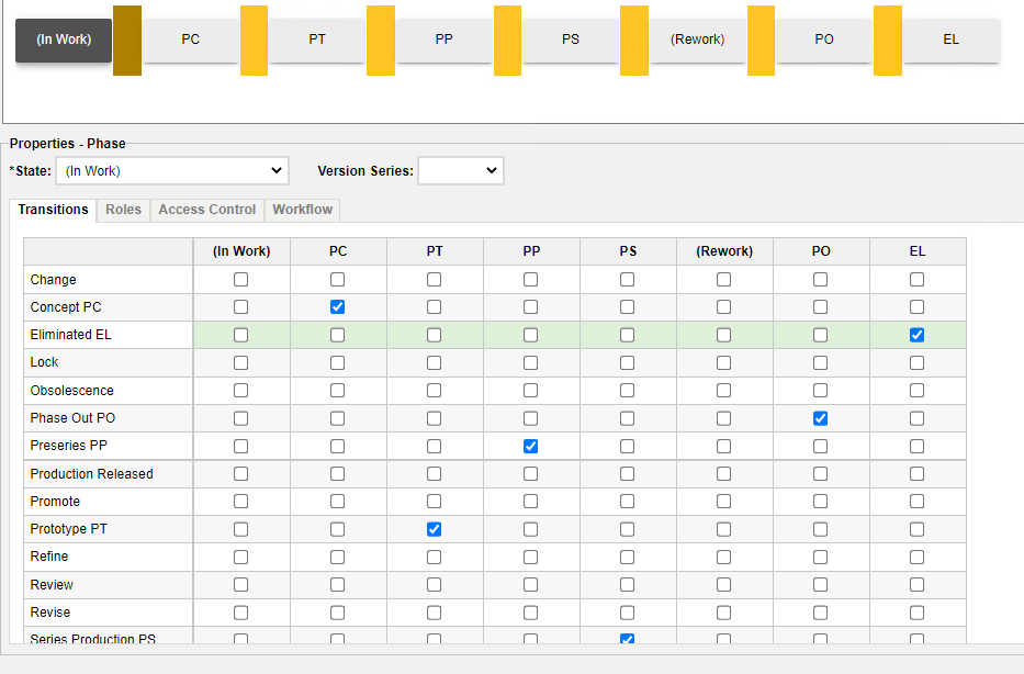

The result in Change management SetReleaseTarget with multiple transitions
LifeCycle of an object

Can you see transitions in a LifeCycle template edit wizard? to be sure that custom transitions are there.
Do you set LifeCycle template to use the transitions? You need to set the transition for each target state.
