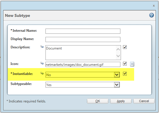

If you have permission to create it, and if the "Instantiable" radio button in Type and Attribute manager is set to Yes, then it will be available to select once you select New Document.

As mentioned above, you need to make sure the Instantiable option is set to "Yes". It is "No" by default. Lots of good information on this in the Windchill Help Center.
Yes, it is set to yes.
It was at No, and I changed it to Yes. I even restarted tomcat and windchill services.
