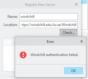

Hi! We've recently set up Windchill at our university and we have problems connecting to the server through Creo Parametrics.
When we add the server through Server Management in Creo Parametrics, and login it says "Authentication failed" (after 60 seconds):

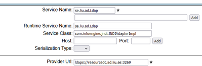

Now what interests me is that Windchill seems to think that the LDAP URL is "ldap://localhost...." when it should be "ldaps://resourcedc.domain.org"
The default DirectoryService in wt.properties is "se.liu.ad.Ldap", which is the same as in info*engine:

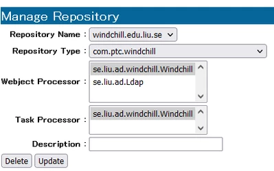

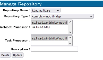

I also checked our repositories in Task Delegate Administration:
As I understand it, it should be correct. I tested changing the Webject Processor to "se.liu.ad.Ldap" but that did not help. I have sinced changed it back, cleared the cache, and restarted the server.

I found the solution!
We've set up a DNS alias for "windchill.ad.liu.se" which is "windchill.edu.liu.se"
I created a new Repository in Task Delegate Administration for the dns alias, and it started working.

When you register the Windchill server to Creo, are you typing in the server name or doing a cut and paste of the URL from the Windchill browser window? If typing it in, try to cut and paste.
Thanks for a quick reply!
I usually type it for hand. I tested copy pasting it this time and it still did not work sadly.
I tested entering incorrect password and the Authentication window pops up again.
Some form of authentication does happen since the "Authentication failed" message only pops up when I enter correct credentials.

I tested logging in with incorrect credentials and the authentication window just asked me to log in again.
Once I use the correct credentials it says "Authentication failed".
So some form of authentication actually occurs.
