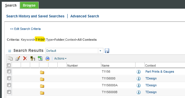

As per the original Post
@mrane , @LoriSood ,
Can you, or anyone else, verify if this works in WC 12+?
Thanks, Lawrence

@LawrenceS (and @LoriSood),
These same steps are documented in CS41798.  I can confirm that following them will allow folders to be searched in Windchill 12.1.1.0. I did have to change the property mentioned in the 'Note' section.  Without this the search results were always zero for any folder name.

@LawrenceS
Yes, it should still work.
@LoriSood  & @TomU,  Thank you very much for confirming that this still works!  We are going to discuss with our consultant and give it a go.

I just want to verify that we implemented this in our test and then the Production environment.  It worked seamlessly and we are now enjoying the new capability!
Thanks again!
