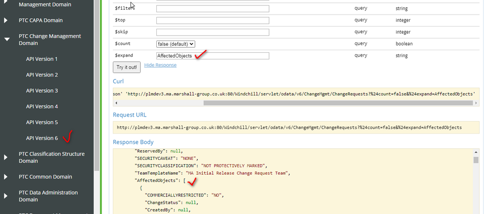

Hi all,
By reading the WRS manual I can see that some tables can be expanded: CR's can be expanded to show AffectedObjects.
/Windchill/servlet/odata/v5/ChangeMgmt/ChangeRequests?$select=Description,AffectedSystem,LastModified,Name,Number&$filter=startswith(Name, 'Foo-')&$count=false&$expand=AffectedObjects

These are shown in example code. Are there other table relations that can be expanded? I was hoping to see RelevantRequestData as something which can be expanded.
Ok, yes, this is configurable, but what is the default?
And which server-side XML configures this?
thanks

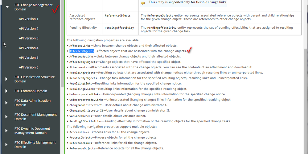

More on the above. My info is for ChangeRequest.
I am using https://domain/Windchill/netmarkets/html/wrs/doc.html  -- In the right frame, GET /ChangeRequests
Clearly I need to learn more about this. I tried expanding these:
"name": "organizationOwned" -- no, cannot be expanded
"name": "VersionedChangeMgmt" -- no, cannot be expanded
"name": "LifecycleManagedChangeMgmt" -- no, cannot be expanded
"name": "ProcessLinks" -- nothing for us,
"name": "ProcessObjects" -- nothing for us
"name": "ReferenceLinks" -- links to a wt.change2.ChangeReferenceLink
"name": "ReferenceObjects" -- links to another ChangeRequest
"name": "AffectsLinks" -- links to wt.change2.RelevantRequestData2 which you will recognize when you have been using QueryBuilder
"name": "AffectedObjects" -- links to Documents

Hi @rleir
Perhaps it's 'navigation criteria' that indicates what can be expanded, then it seems to depend somewhat on context.
For example, there is a 'resultingobjects' nav criteria, but we would not expect to expand change request to on it.
rleir
(To:rhart)
Hi Rhart
Good eye, the navigation criteria identifies things that can be expanded. I marked your reply as the solution, thanks! Though there seem to be some big gaps in the doco for the 'expand' feature.
