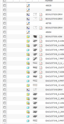

I'm currently trying to implement an improvement to our Windchill system and utilise the pdf quickview option available. This is intended to simplify things for our purchasing department. I have activated the plug in and have run into a problem. It appears to only be working for released drawings and parts that have been checked in using our worker station, this generates files in pdf format so no issue there it works as intended. However over the last decade or so various engineers have taken the easy route and checked drawings in using a 'custom check in' method which uses there on computer, this has generated files in .plt format and as such isn't giving the pdf quickview icon.
Doe's anyone know of any quick fixes for this? Is it possible to make the quickview work for .plt files as well?
The only other option I can see is republishing all .plt drawing files, there are thousands in question - any mass republish tricks around or will this need to be done a single drawing at a time?

Hi Tom, yes I am meaning quick access. I have configured as shown in the PTC documentation, we get pdf icons for some parts but nothing for others. I think it must have something to do with viewable file creation.
TomU
(To:JM_10142387)
Quick Access is only exposing PDFs that have been generated as part of the publishing process.  If objects do not already have a PDF created, no icon will appear.  You should be able to verify which ones have PDFs by right clicking on the representation and looking at the 'Files' section:
Anything without a PDF would need to be republished, either manually or with a batch job.  Just make sure you have publishing configured to generate PDFs before you kick off a big batch republish!

Thanks Tom, that is what I feared. We have thousands of drawings that have been generated without pdf output, any tips on how to run a mass republish for that many drawings?
You do that a couple different ways.
-As an admin you have the WVS job Scheduler Administrator.  You can create your own jobs.  I prefer to use this one.
-On the back end on the server you log in as admin too through a command prompt.
TomU
(To:JM_10142387)
Yes, see knowledge base article CS211115.
In section 2 about halfway down it talks about PublishEPMDocWithCSVFile.  There is a zip file with compiled code.  You extract this to a specific folder in Windchill and then run it from a Windchill shell.  You will feed into it a csv file (really just a text file) with a list of all the objects you want to republish.  It will then automatically delete any existing representations and submit them all for republishing.
It's fairly straight forward to construct the csv file from a SQL query, assuming you have direct access to the database.  Essentially you just find all latest released objects (or whatever you're looking for) where the representation does not contain a PDF.  Let me know if you need help with the query.

I've ran a quick test and everything that has been checked in to our server manually via 'custom check in' has generated the file type as a .plt, this doesn't work with the quick view options, it also appears that drawings that have been checked in some time ago on old versions of creo have not worked either.
So looking like manual republish is likely. Only 1300 drawings to do....
