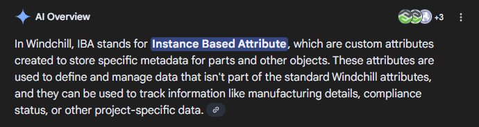

Hi @HelesicPetr ,
Could you expand on your feedback please? I don't know what iba means sorry,
Antoino
HelesicPetr
(To:Bearanto)
Hi @Bearanto
PetrH
