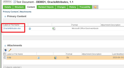

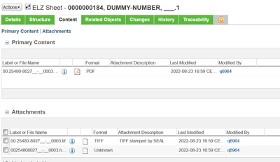

Has anyone tried to figure out the way to be able to only download secondary content from WTDocument and prohibit download of primary content at the same time?
Assuming we have this table "Primary Content" and "Attachments" - I would like to be setup ACLs in a way to be able to download Attachments, but not Primary Content.
Obviously I setup already the ACLs in a way that "download" is prohibited for this type of WTDocument. But the goal is to be able to do it without changing Java code of related data utility.
Any ideas?

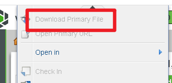

Hi @HelesicPetr

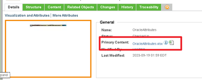

I have written a custom filter to disable download primary file for specific conditions, but users can still click on the Primary Content link in the attribute to download, as shown in Figure 2, how to disable the link in the attribute to download together? Thanks for your help.

Hi @CZ_9645217
You need to modify DataUtility for the Primary Content  (primaryAttachmentProperties)
In your code you need to catch the link and remove the link from the datautility result.
service configuration
<Service context="default" name="com.ptc.core.components.descriptor.DataUtility"
	targetFile="codebase/com/ptc/windchill/enterprise/enterpriseui.dataUtilities.properties">
			<Option cardinality="duplicate" order="0" overridable="true"
				requestor="java.lang.Object"
			selector="primaryAttachmentProperties"
			serviceClass="cz.aveng.HELTest1.MultiComponentDataUtility"/>
	</Service>

Thank you very much for your quick reply, as with the previous question, the primary can also be downloaded from the Content tab, does that mean I have to re-customize this tabale as well? Thank you.
HelesicPetr
(To:CZ_9645217)
@CZ_9645217
Unfortunately yes...
