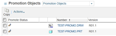

Hi, we are having a problem with our Promotion Request workflow.
Sometimes we come across a situation where at first only WTParts are added to a Promotion Request as Promotion Objects:
We use "Pending Approval" state to lock objects that are added to Promotion Requests so that they are not edited during the review process (because the promotion process seems to be unable to refresh the latest iteration automatically to the PR).

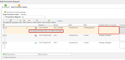

At this point the WTPart is moved to that state.
Then when the Promotion Request is later edited and the related CAD documents are added to Promotion Objects, the WTParts drop out of the Promotion Objects because they are in the "Pending Approval" state, which we are not allowing to be promoted:
Now at this point the WTPart gets stuck to "Pending Approval" state even though it is not in the Promotion Request anymore:
And someone with Admin or Product Manager access needs to now go and use Set State to change the state back to In Work so that the WTPart can be added back to the Promotion Request.
I know that we can get rid of this behavior by allowing Promote transition from Pending Approval state, but that would also enable people to accidentally add one object to multiple Promotion Requests.
Is there any other solution for this problem? And why is the WTPart not reverting back to its original state when it drops out of the Promotion Request?

We use the Pending Approval state as the lock state in the Lifecycle. And it is working otherwise okay, but we have this problem with WTParts dropping out of the promotion objects when the Promotion Request is edited.
To me, this is the issue:
We don't allow the Promotion Request to be edited while anything is in the locked state. Our workflow has a rework path, which changes the Promotion back to an editable state and unlocks everything in the promotion. Then the user can add items, and now set everything needed for promotion again. When the promotion goes forward, all the items are locked again for review.
There are other ways to manage it, like others are commenting, but to me, this is the easiest.

We added the Promote transition from Pending Approval to Released, so the objects are not dropping out of Promotion Requests anymore when they are edited. But we still have the problem of some objects getting stuck to Pending Approval state when they are removed from Promotion Requests or if Promotion Requests are deleted.
There seems to be some kind of a bug in the process that should update the state of the promotion objects when they are not a part of a Promotion Request anymore.
