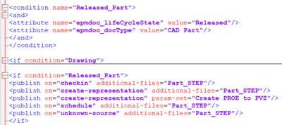

It depends how you have the rules structured. Like @HelesicPetr said, if you add a bit of your publish rules it would be more informative.
Your conditions need to be pretty accurate based on what your desired result is.
Here's a snippet that works:
Condition is "Released_Part" and on that condition there are certain triggers.
Order of things matters for fall through matching.

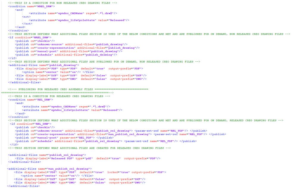

jbailey
18-Opal
Apr 25, 2023 10:21 PM UTC
