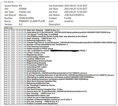

I started proeworker manually, then submitted a job. Here is the job log.
There is no thumbnail created and there is nothing in the file when opened in CreoView.
This is a job log from my other Windchill 12.0.2.12 server that runs automatically.
CrieView Adapters were installed using the same procedure on both systems.
Cannot figure out why I am not getting the thumbnails saved for display in CreoView.
