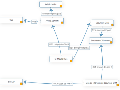

From what I read in these documents, it does not cover how to obtain the epmdocument in calculated link. I assume it is not possible to obtain this information?
For the moment I manage to:
- list the WTparts having an owner link with an EPMdocument
- Obtain the drawings being in drawing reference with the EPM document which is linked to the article in owner link
- Only show the latest versions/iterations of objects
Ideally we should also be able to exclude WTparts having an EPMdocument (drawing) in content link which is the same as the EPMdocument that I obtain by browsing the drawing reference.
Is it possible to exclude WTparts by a condition?
See my diagram below :
AG
Not sure I understand what you are asking for.
Each part can have several EPMbuildRule links : an owner link to an EPMdoc which holds the CAD, and another EPMBuildRule which is not 'owner' to an EPMdoc which holds a PDF drawing, and maybe another still.
See if you can get the QB working from https://community.ptc.com/t5/Windchill/Finding-WTPart-Relationship-in-CAD-Document-Retrieval/m-p/950131#M80297 then see what non-owner links you can find.
The "calculated" link means there is code being used to determine the link, it's not a real link in the database.
The QML doesn't see "calculated" links, only real links in the database. The Drawing is actually linked to the CAD, which is linked to the WTPart. You can still report on this data, by using the real links. It looks like you already figured out how to do that.
