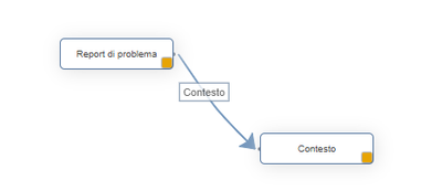

What you did was make a report, created at the organization level, visible in every single library.
This way, there is no context filter that needs to be created by adding the context table and linking it to the Problem Reports table and MANUALLY selecting the context you want the search to be performed on.
Something like what you see in the image below.
