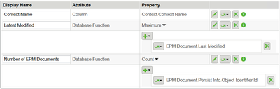

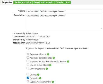

My report is now set up as follows :
Tables and Joins appear very simple, but was in fact the last issue: that arrow direction is important: FROM EPM Document. I don't fully understand why, but it is important.
The example report also showed me how to add database functions correctly in the new user interface. Also, the Count of Identifier.Id was really helpful here.

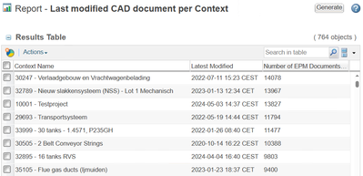

Eventually the Results Table shows exactly what I expected.

I have managed to import the QML file in the organization where I want to see this summary, but I don't understand why I need to add Criteria there. I tried to only report on Number of Latest Iterations = 1, only on a specific Context Name, ... but always get 0 results ?
Is it possible to retrieve a table for all contexts ?
Edit: Select All criteria and leave all inputs empty now resulted in 746 contexts, but the filesize can't be that small 🙂
