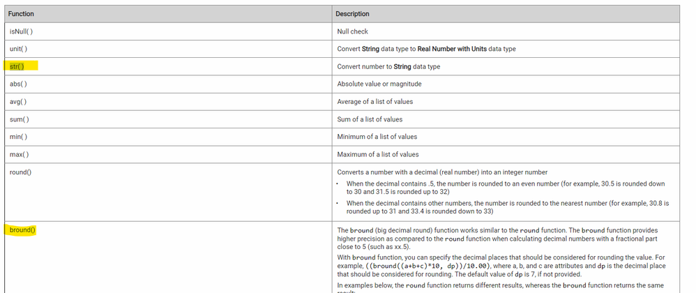

OOTB ,this can be done with calculated attributes fucntions,yoy can use bround() for decimal precision and str() to convert to string
 https://support.ptc.com/help/wnc/r12.1.1.0/en/index.html#page/Windchill_Help_Center/typeattr/TypeMgrAttrFormula.html
