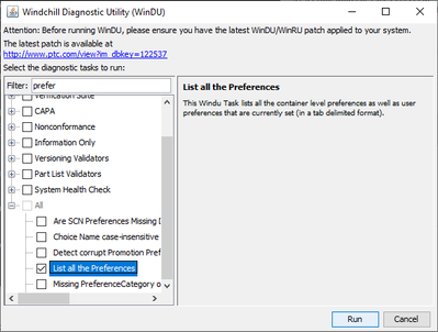

Is there a way to print out the Preferences?
There is no utility directly from Preferences.
It's possible but very challenging to create a query builder report of preferences.
WINDU actually does a decent job of generating a report of preferences.
note: Super important to make a comment every time a preference is changed, because it's possible to grab the changed ones by those comments.
note: Good to always leave Site alone and make changes at Org; can return to OTB condition easily.
Mike L.'s mention of the WinDu utility, is what I was going to suggest as well:
