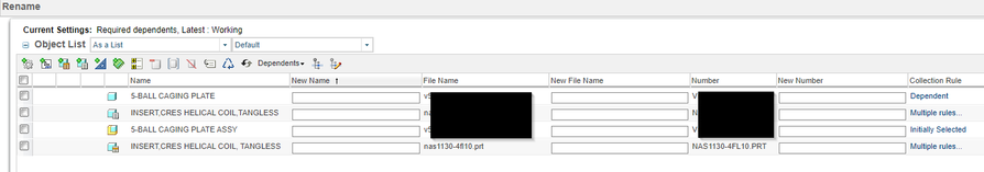

I have 100 components in a single assembly, I want to rename all the components like number, name & filename. Can we use the export from the spreadsheet for this? Actually, I tried to change the filename on this method, but I can't change the name & number. Can you help me with how we can do this?

This is standard OOTB functionality. If you rename a CAD assembly, you can use the collector to get its dependent models and rename, renumber or change filenames of them all in one shot.

                 I import all the details using the import from spreadsheet method, there I can change the filename(Common name), I want to do the same thing for numbers and names. I tested on here if I change the name or number in WT Part it's created with a new number, not updating the latest modified.

The spreadsheet does not support changing the numbers. Number is unique identification and the spreadsheet do not allow you to define old and new one.

Agree with @HelesicPetr , export/import is not the right method unless you are trying to make new items, not rename/renumber existing items. I am bit confused on your steps. I am familiar with Export of Importable Sheet with WTParts but not for CAD. Can you explain your steps and process with screen shots perhaps?
