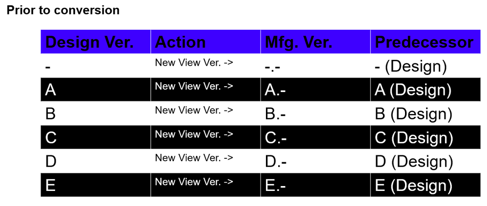

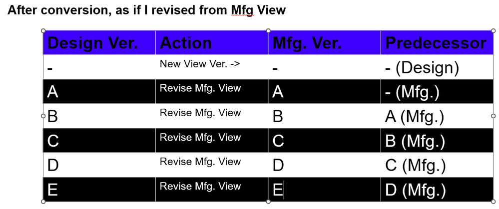

I wrapped up my questions to PTC with utility "works to specification" which is not the deep level of understanding I was hoping for, I was assured that things like purging and deletion would be unaffected but I want to test that to be sure or at least document them. @Marco_Tosin, let me know if you've seen anything odd since you said you ran this before me.
Here is what I wanted to document. In our use case, all MFG views were created from the Design view using "New View Version". We never revised from the MFG view downward.
I am sure the conversion had to make some compromises for other use cases but the database does record the predecessor version in its tables showing it came from the Design view in each case. Post conversion, except for the first version of the MFG view, all now show as revises.
While the predecessor version was altered, as mentioned in my previous post, the iteration that the version was created from was retained showing the Design version. The database records somewhat disagree with each other. PTC indicated that this was ok and should not impact integrity and functionality. I have to their word for now but I will close with some testing results. I just wanted to clearly document things for others though I expect I am a behind the curve on this one.

Hi @avillanueva,
sorry for the delay but I was waiting for our consultant to have time to explain, even to me, what he had done before sharing it.
Below is the explanation of how we solved what you are experiencing as a problem.
The behavior you are observing seems to be the default of Windchill when using the single-level revision schema.
This occurs because, when directly revising the manufacturing view, the predecessor of the new revision is indeed the previous revision of the same branch of the view.
We assume this behavior is indeed what PTC intended, as in the context of a system managing the manufacturing BOM, PTC likely envisions the installation of the MPMLink module and the management of the information regarding which design view generated the manufacturing view through equivalence links.
To overcome this behavior, we implemented a custom listener that, during the revision of the view, navigates backward through the control branches of the object, determines which design revision gave rise to the manufacturing view, and sets a custom attribute called "Design Revision" with the expected value.

Just providing some updates on this topic. I completed a second conversion and ran the query I posted as solution here:
This shows me what the versions need to be to align with Design View. I was able to reduce that to just updating by branch ID to sets of these updates scripts in this form:
UPDATE WTPART SET versionida2versioninfo='B' WHERE BRANCHIDITERATIONINFO=1153919464;
UPDATE CONTROLBRANCH SET VERSIONID='B' WHERE IDA2A2=1153919464;
12K lines later its complete with a few zone constraint violations. I needed to make sure I run them from latest version backward. Can't have two branches with same letter. Spotted some errors that I was able to manually correct but its done. Next on to some code updates to block revising in certain conditions.
