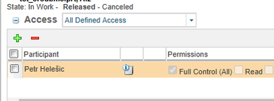

In the OIR i set for a user Revise NOT possibile in only Released stase in epmdocument. For other states, for example draft, revise should be possible. But is already obscured

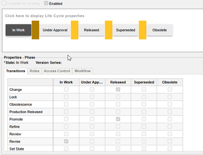

Blocking revise can be done in ACLs and also in the Lifecycle definition. Can you post copies of both here? For clarity, you are seeing that its not possible to revise in Draft, but option is greyed out?
Configuration of ACLs rules on Approved status and Draft status
In draft status Revise icon is missing

Lastly, we should check the lifecycle template for your EPMDocument. Do you have Revise checked? This is showing its allowed in my In Work state but my ACLs only allows admin to do that.
Hello in attached debug, list acl rules and lifecycle. Seems to be right.
Perhaps in debug we should know what the problem is

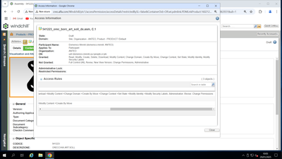

This ACL definition is ok, but you do not know if there are not any others definitions that could involve the results.

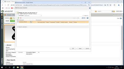

So go to the EPMDocument in the draft state, and use a Edit Access Control
Go to the detail info and check the ACL results and share the screen shot.
PetrH

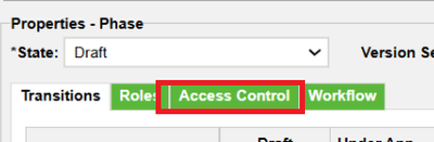

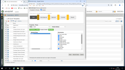

As you thought revise is not checked in draf

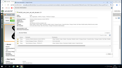

Hi @FC_9723361
Go to the detail of the row by the IHelesicPetr_0-1738139540100.png icon.
You will see where the ACLs are defined....
PS> be careful with Deny usage.
Absolute deny rule on any domain level will not allow to use the revise function even though it is allowed on a lower domain level
Deny rule can be rewritten on the lower domain level but if the Deny rule and Allow rule is on the same level, the Deny rule is applied.
Keep this rules in your mind.
PetrH
Now revise is able in details, but is always unchecked
HelesicPetr
(To:FC_9723361)
Hi @FC_9723361
As I see your ACL rules are set directly on the User
I can not see all the rules defined please slide to the left to see the end of the row
The result is clear. You do not have granted access to the Revise
Check the Lifecycle Access control
it seams that somewhere the access is denied
PetrH
For the author revise is available, but if it is not the author ma only the modifier ? Should be this the problem?
HelesicPetr
(To:FC_9723361)
Hi @FC_9723361
I see the root  case.
Your ACL rules define the Deny rules directly on the user. So others rules are rewritten.
The MINUS means Deny. So your ACL definition contains a users level ACL definition that rewrites all upper rules from domains.
Change it and the user will get the Revise rights.
