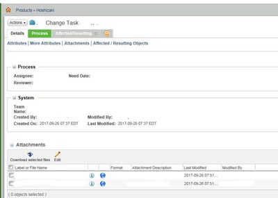

I was wondering if there is a SQL table for the Attachments portion of a CN Task?  We have a bunch of links in the CN Task area that are pointing to a server name that has been changed.  It would be nice if these were stored in a table and I could just change the link from the database side.  Anyone know if this can be done?
We are on Windchill 11.

Hello Marco,
That contains a lot of good information for affected/resulting and tasks.  But it doesn't seem to have where attachements are.  I'm hoping they are not blobs.  This is the information that I am looking for from the task.

Hi Brian,
The attachment data is stored in ApplicationData table in the database, here is the query you can use, Just provide the CA Number in the last line also to know if the item is in BLOB or vault you can just say it by value of CLASSNAMEKEYA5, if its "wt.fv.FvItem" it's in Vault , Let me know if you need more help. :
select appData.FILENAME,appData.CLASSNAMEKEYA5,CAMASTER.WTCHGACTIVITYNUMBER from APPLICATIONDATA appData, HOLDERTOCONTENT HC, WTCHANGEACTIVITY2 CA, WTCHANGEACTIVITY2MASTER CAMASTER
where HC.IDA3B5=appData.ida2a2 and HC.ida3a5=CA.ida2a2 and CA.ida3masterreference=CAMASTER.ida2a2
and CAMASTER.WTCHGACTIVITYNUMBER='CA-075729'
