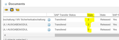

Traffic attributes are not display correctly in custom table view its only showing number (1,2,3)
VP_10061679
I am using Windchill PDMLink Release 11.1 and Datecode with CPS M020-CPS12
Hi Team,
I am able to create Traffic attribute and it is showing correctly on part information page but when i am using same attribute on customize table in a column it is only showing number (1,2,3) instead of graphical view. Please help to resolve it please find screen shots.

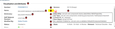

You might have neglected to call for the right data utility. When viewing the correct view on the part info page, add "&jcaDebug=true" to URL. You should see a bunch of lady bugs appear. Look at the one next to the traffic attribute and it should show the data utility. That needs to be called out in your table definition.
Hi
Thankyou for reply. That datautility is showing on multiple Lady Bugs. please see below two
Data Utility :com.ptc.core.components.factory.dataUtilities.NBSPDataUtility
Not sure that is the right one, NBSPDataUtility I think is just spaces.
Then i did not find any lady bug for traffic lights, please see below screen shots all highlighted one is 'NBSPDataUtility' and for Traffic lights no lady bug Showing 😞

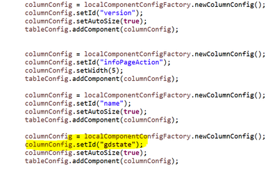

I have created a table builder as below and configure the graphical attribute named "gdstate"

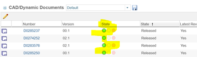

 here Graphical attribute "gdstate" is working correct with other ootb table but not working with custom table please see below screen shots.
working correct with below OOTB table

Thankyou ,
that's working now .
columnConfig = localComponentConfigFactory.newColumnConfig();
columnConfig.setDataUtilityId("graphicalAttribute");
columnConfig.setId("gdstate");
columnConfig.setAutoSize(true);
tableConfig.addComponent(columnConfig);
