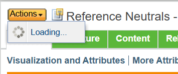

Hi Team,
Need some help from the community.
Unable to see the Actions list when click on Actions for the WTDocument in Infopage.
When select the WTDocument in folders page and click on Actions it does show all the list.
Any idea wht could be the probable causes.

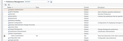

Enable client customization and reload action :
1- Site > Utilities> Preference Management> Client customization :

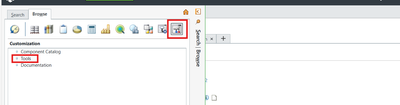

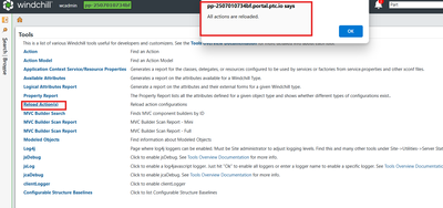

2- client customization > tools > reload actions :

Sorry no success.
I guess need to check in custom-ActionModel.xml if something is wrong
