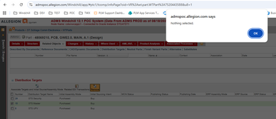

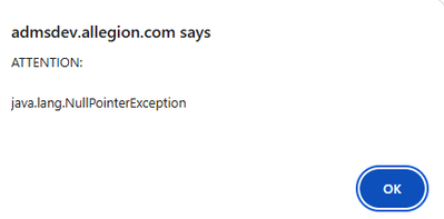

Unable to Remove Distribution Target from WTPart
11025060
11-Garnet
or when I select 'ALL'
missed
tableConfig.setSelectable(true); in our custom code, once I added it, it is working

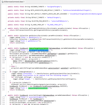

Please share the related MethodServer logs for more details about the issue.

2025-12-24 09:15:20,530 ERROR [ajp-nio-127.0.0.1-8010-exec-176] com.ptc.jca.mvc.controllers.ActionController abcuser - java.lang.reflect.InvocationTargetException java.lang.reflect.InvocationTargetException

Caused by: java.lang.NullPointerException
	at com.ptc.windchill.esi.svc.ESIServicesCommand.removeTargetAssociation(ESIServicesCommand.java:143)
	... 67 more

enable logger com.ptc.windchill.esi.svc.ESIServicesCommand  to DEBUG , reproduce the issue and share stacktrace

2025-12-24 11:46:05,845 DEBUG [ajp-nio-127.0.0.1-8010-exec-183] com.ptc.windchill.esi.svc.ESIServicesCommand abcuser - Enter => removeTargetAssociation()
2025-12-24 11:46:05,849 ERROR [ajp-nio-127.0.0.1-8010-exec-183] com.ptc.jca.mvc.controllers.ActionController abcuser - java.lang.reflect.InvocationTargetException java.lang.reflect.InvocationTargetException
	... 66 more
missed
