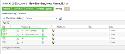

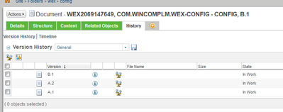

There is nothing wrong with the query and it gets the expected outcome, documents remains editable :
  • update WTDocumentMaster set WTDocumentNumber = 'New Number', Name='New Name' where WTDocumentNumber= 'WEX2069147649';
You might need to check with the admin if such change is allowed in your instance, not violating some business rule.
