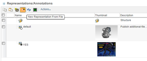

my exapmle >D

Hi @N-Pyn
Try the following article cs216138
Article describes how to customize and add a new wizard to create rep. from file.
I tried it and it solve the issue that can not use the OOTB wizard for JPG.
custom wizard has just input for files from local drive
You can see an example with original visualization and new default jpg visualization
