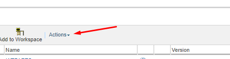

onur_0-1664369760408.pngI want to add a dropdown that I created to the toolbar, how can I do it?

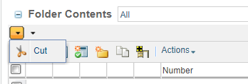

Example how it looks like (i didn't define the name of submenu so it is without names :D)

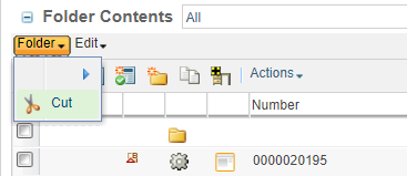

A label is shown with own resourceBundle definition

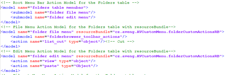

the customActionModel definition has to be done.
Check the help link I provided. There is description how to do so in other sections.

If you talk about labels then you need to write own class to specify the labels.
Class example

customActionModels definition with resourceBundle class
