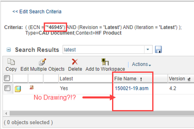

We have an interesting case where we perform 2 different attribute searches looking for CAD objects but the wildcard search shows less results than the non-wildcard search!
For example if we search by our ECN attribute:
ECN Attribute Search Number results Type  of results
0046945 2 asm and dwg
*46945 1 asm only
*46945* 2 asm and dwg
46945* 0 none, as expected

  1. Does anyone know why searching with a star at the beginning of an attribute requires a star at the end to get all the results, even though there is no difference in the attribute text saved with the cad files?  Also why the asm comes up but not the .drw?
  2. Do you know how to fix this?

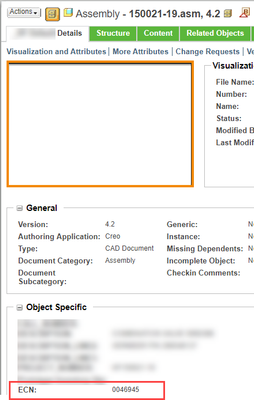

What does the detail information page show for that object in Windchill?
Yes, detail pages show the identical attribute value
  • asm

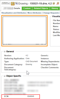

  • .drw
This is very bizarre.

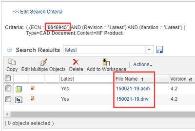

And here are screenshots of the 2 searches:
  • Complete attribute (no wildcard stars):
  • Partial attribute with wildcard star replacing missing text:
Again, between these 2 searches all I did was delete the 2 zeros and replace with a star, then made sure both searches used the same view (latest in this case...although I tried various views to make sure no filter buried inside one of the view's criteria themselves).

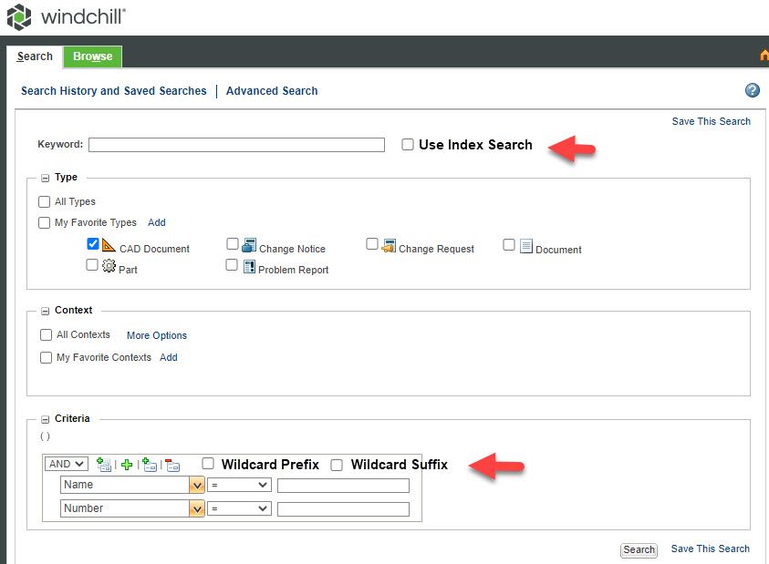

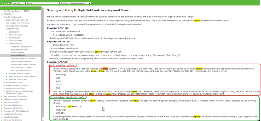

Unfortunately those links didn't work (I think they are to your company's installation of the help files), but I tried to search for the simple one on PTC's website and perhaps found what you were referring to on spaces and wildcards:
From this I gathered some especially important points about INDEXED searches:
  • "WC Index Search does NOT index spaces"! (emphasis added! 🙂)
  • "Spaces are only used to split data into distinct keyword strings."
This still doesn't explain non-indexed searches though because:
  • "WC database searches interpret spaces literally"
  • "...non-indexed search...keyword term must account for every character in the value field, including any spaces."
According to this documentation I think that non-indexed attribute searches should contain the spaces.

I think we should start by identifying the documentation for search. It was scattered across several documents, articles and online help resources when I was looking a few months ago. It needs to be described in detail in one place and I should not be relying on my knowledge of Solr (especially since Solr can be customized to work differently in an app).
Then we should decide where search is done. There is the Keyword field, and below it in Criteria there is a name search and a number search. At the top right corner there is a quick search. Other places too? I suspect there is a difference in the wildcard handling (please confirm?). These should all work the same from the users' point of view. But my guess is that the Keyword search is done by Solr and the criteria search is done by a database? If they all work the same then sorry, please disregard this.
This might be a red herring: did search change from WC 11.0 to 11.1 to 11.2? If so the documentation should reflect this, not just in the patch release notes.
With the groundwork done, your question might have some clear answers.

Solr is designed to give you the best matches, in ranked order. It's idea of 'best' could be different from your idea of 'best', and the one result that you really want to see might appear on the second page of results.
This issue is compounded by the nature of Solr: it is possible (though exceedingly unlikely) for your admin to find the Solr config XML file in the WC server and change the search behavior. If there was a change in behaviour between WC 11.0 and 11.2, then I would be suspecting that PTC had changed this Solr config.

My preference would be for quick toggles that could also be used used in 'Saved Searches' or have preferences to control the defaults. Something like the image below:
