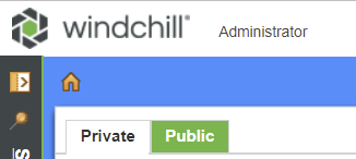

For my 11.1 installation that I did last month, I modified this file:
<Windchill>\codebase\netmarkets\themes\windchill\xtheme-windchill.css
In that file, look for:
#contentPanel_contentArea {background-color:
There is a number after color: and closed with a }
I use a medium blue color for the background:
#contentPanel_contentArea {background-color:#1e90ff}
