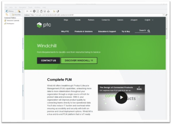

I have a User who is asking me if there is a way to shut off the splash screen and have WGM open directly to his Workspace?  We are using WGM for Inventor.  I suspect there isn't but thought this group might have a way.
Current View: Current starting view_
Desired starting view:
Desired View_

Yes, just change the home page preference (in the wgmclient.ini file.)

@TomU  Thanks! That looks like a good solution, but what's the best way to access the wgmclient.ini file?  I wonder if it matters that I have a cloud set up?
TomU
(To:JHall)
I highly doubt your workgroup manager is running in the cloud.  By default the file is located in the "C:\Program Files\PTC\wgm" folder.

Thanks @TomU  I'll ask my User if he wants to move forward with this.  Looks like it should work.
Oh and yea, it was exactly where you anticipated it would be.
