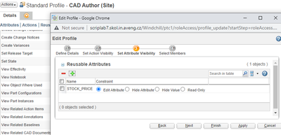

HelesicPetr
(To:joe_morton)
Hello Joe,
You can use also OOTB solution.
Profiles can restrict an access to a specific attributes.
Very easy to use.
Set the profile for user or group and set the Attribute Visibility.
Add all members to the profile who should have restricted access to edit.
I like this solution even better. Thanks!
