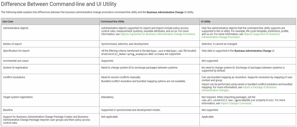

BAC is a tool used for exporting and importing context from system a to system b
The supported context includes the following:
Cannot be used across versions, error will be reported
If you want to export more content, then BAC is no longer sufficient, consider Rehost (Clone)
It can be used by commands and UI, but there are differences, you can refer below
Cannot be used to update windchill, to update windchill, you can install CPS through PSI(like 11.1 M030 CPS01 → 11.0 M030 CPS14) or use UpgradeManger to upgrade the windchill(like 11.x→12.x)

Business Administrative Change utility
CS330275 - Windchill PLM - Business Administrative Change Utility (BAC)
It is utility to export and import data and settings "from/to" system. It is not usable for upgrade.
