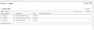

Use Case: ers are stored in the database. My goal is to retrieve or audit which users were added to specific discussion topics for traceability or automation purposes.
Description:
I'm working with the DiscussionTopic feature where discussions are grouped around a document or a specific object, and notifications or communications occur among users added to that topic.
I was able to find the DiscussionTopic I created in the database. However, I couldn't find where the users (members) associated with this topic are stored. These are the users I manually added to the discussion, but I cannot locate their records in the database.
Could someone help me understand where I can find the list of users linked to a DiscussionTopic?

The discussion may have groups or users .
Use attached qml report as start :
