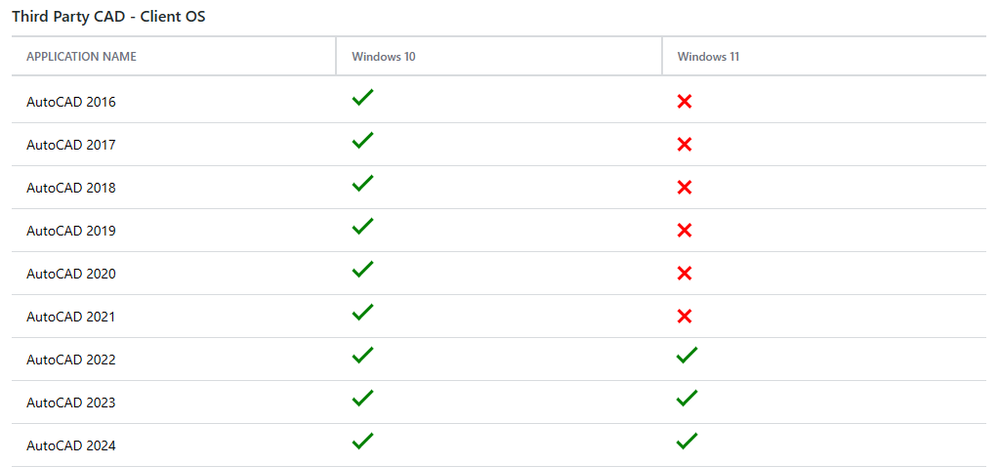

Is there something for the AUTOCAD
TomU
(To:AP_10483126)

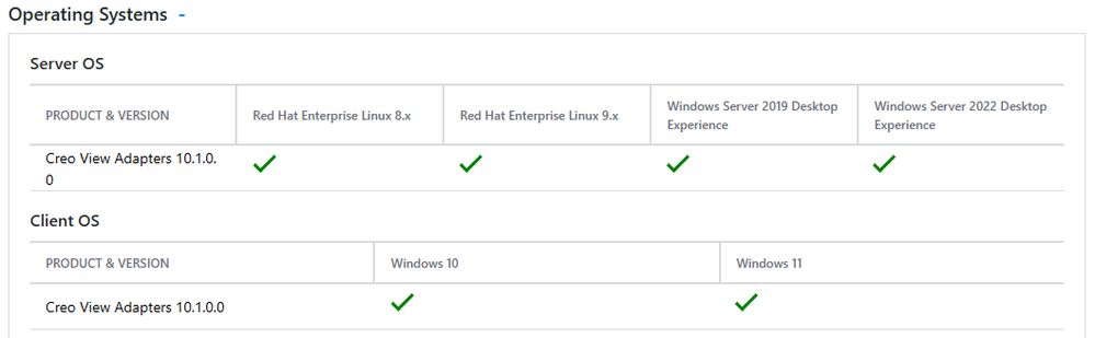

The product matrix shows AUTOCAD being supported on Windows 10 and 11 (depending on the version.)  The Creo View Adapters will run on a bunch of different operating systems, so it's not the limiting factor.  You may still be able to get the AUTOCAD worker processes running on a server OS, but it would appear it's not officially supported by PTC.
Creo View Adapters 10.1.0.0 Release Matrix - PTC Release Advisor
Windchill Workgroup Manager 13.0.1.1 Release Matrix - PTC Release Advisor
