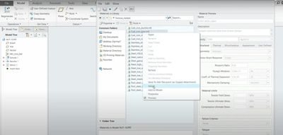

Please see the below image. There are collection of materials in the Creo library.
I want to understand on
1.)how these materials are managed in windchill side. (as an EPMDocument of type=MTL?)
2)how can i further link these materials on EBOM WTParts?
3.) What is the best strategy to consider while doing data migration of Materials to Windchill?
Thanks in advance

These would just be normal EPMDocument objects. If there is an association, it would be to a PRT model EPMDocument. There would be no direct link to any eBOM (Part) object. The only way to show that at the eBOM would be to create an alias attribute to navigate to the linked CAD model (EPMDocument) then to the material EPMDocument. Might be easier to create a report but you will have gaps.
You can set the material attribute in Creo as a designated attribute, so on check-in the material name will be visible on the CAD object. You can have this propagate to the WTPart as well so that it's viewable in BOMs. There's no direct link in that case to the material library object stored in Windchill.

So, a Material can be linked as to an PRT EPMDOCUMENT and WTPART in the form of an attribute.
