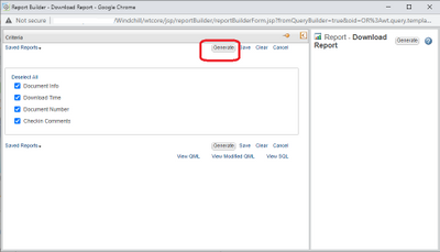

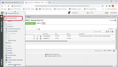

I wrote query report that is run from the action menu of the WTDocument (or EPMDocument).
In short, the action opens the report after automatically passing the object's id to the report.
The manager just has to select the action in the actions menu and then the Generate button and that run the report which displays who downloaded the file, when they downloaded it, etc.
Works well and can be expanded.
Looks like this.
When the *Download Report button is selected a Report opens that, in the background, has been automatically edited to use the object whose page was used to open the report as the search criteria.
Results can be whatever is required.  This is just to show it's doable.
Results

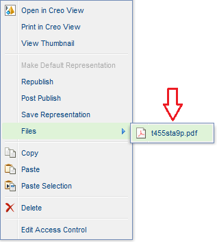

I sort of wondered if this might be the case.  Just out of curiosity, does the download event catch the downloading of additional files from the published representation?
TomU
(To:TomU)
Wow, I should have read the article in @avillanueva's reply first.  I guess that's a 'no'.  🙄
Key also on this is that any number of people may have looked at a published drawing in Creo View - no way to tell which of these people may have provided this info to a vendor.
