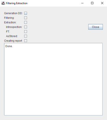

I am currently trying to filter the extraction to only extract objects of an specific Organization. For that i tried to do a filtered extraction. The Filter most likely doesn't work as it is right now,but i didnt even get to test it.
I tried executing following command: windchill com.ptc.windchill.migration.wbm.wc2wc.extractor.filter.WindchillFilteredExtractor -u wcadmin -p wcadmin -d
my Windchill version is 12.0.2.8
Here are the logfiles:

[2023-Nov.-15 15:33:15,956] [main] ERROR filter.WindchillFilteredExtractor                 - Error:
com.ptc.windchill.migration.wbm.wc2wc.util.WBMException: java.lang.NullPointerException: No FilterOption xml is found.

This is what i see before as soon as the exception is thrown.
my FilterOption.xml File is at the following location: "D:\ptc\Windchill\Windchill\codebase\com\ptc\windchill\migration\wbm\wc2wc\extractor\filter\FilterOption.xml"
I had to create that file, since there wasn't one when i looked for it. I also copied the FilterOption.xml and renamed it to FilteringOption.xml, since i read both names in different documentations.
Is this even the right directory for the File. If the FilterOption.xml file should be there by default, does a command create it or is it there as soon as the extraction tool is installed?

Page 88 in:
https://www.ptc.com/support/-/media/support/refdocs/Windchill_Bulk_Migrator/11,-d-,2/WCBulkMigratorUtilInstallUsage_11_2.pdf?sc_lang=en
Which version of WBM are you using?
What do you have in FilterOption.xml?
Julian_L.
6-Contributor
(To:rleir)
Thank you very much. I was using an outdated Documentation. The Link you provided helps a lot.
