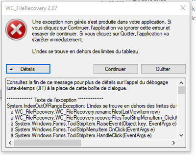

Hello Ron,
Hello Ron,

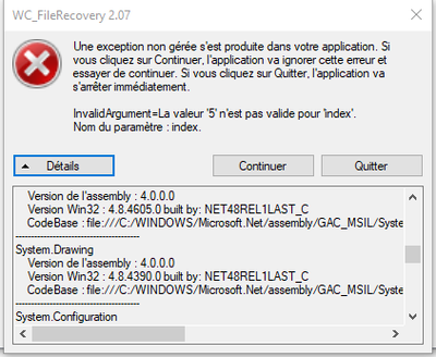

Thank you for this tool, really useful to assist my users.
Since few days, when I use it to recover mainly all sid_ files I have an error message that I never had before.
Sorry it's in french 🙂 It says invalidargument= the value "5" isn't valid for "index", parameter name = index
Could it be linked to Microsoft update, security strategy internally or just cache corruption ?
Best regards
Stéphane
MarcoTosin
April 27, 2023
April 28, 2023
Hello Marco,
Thanks, I tried but similar error message "the index is outside the bounds of the array"

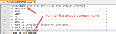

The one problem I see with this tool is that if the users use a different common name on the file than the file name, then this tool is grabbing the common name to rename the files instead of the file name. I've been trying to script something that will do this properly but have had only partial success.
Just using windows command this is what I've come up with so far for parts & assemblies. Drawings are a bigger problem.

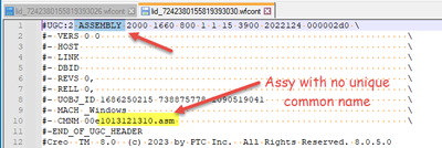

File headers contain the file type & the common name:
Our current script tool is keying off the common name in line 10.
However, this doesn’t work if the file has a unique common name as shown in this example
This file header shows an assembly that has not had the common name customized.
Command to find the files we want:

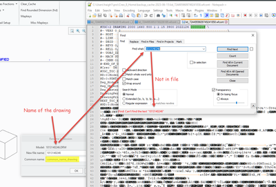

Drawings are a big problem. They don't have a pname in the file.
instead of pname it just has name, but you would have to search for lines that begin with name, otherwise you there are two many matches.
However that isn't true for all drawings. If you use a different common name on a drawing, then what I show here is out the window. and I can find no string in the file that shows the actual name of the drawing.
I don't think most folk would use a common name for a drawing, since they are likely looking for a drawing number anyway. But it is possible to do in Creo.
Anyway this is as far as I've progressed in trying to solve this.
June 15, 2023
Based on what I’m seeing in the Creo files, I don’t think there is a way to get back to the actual part name of the drawing file if a common name is used on it.
This may not matter as much since if all the parts and assemblies are renamed correctly then the drawing will open as it should, and the drawing can then be renamed based on what is in the drawing number field of the drawing.

First is the exception that StephaneG is experiencing.
That is a bug that was fixed in the 2.08 release that was made available when I retired in 2020. It was previously found here (https://community.ptc.com/t5/Windchill/Windchill-Cache-Recovery-Tool/td-p/181971/page/2) but when I click that link now, it redirects me to a different page that states "This Content was Archived". I'm not sure why the post was archived, but that entire thread is gone. Perhaps someone can click the "Request Unarchive" button on that page.

Third is Dave Haigh's comments regarding the recovered filename.
Dave, you are doing the same as me in my code, but I'm using Regular Expressions to find the information. The line that includes CMNM at the start is what you see in the Alternate Name column of the results. Then I look for "name", found in the body of the file, and capture the text following that string. If found, that is added to the Preferred Name column. If the Preferred Name is found, this is used to name the recovered file. If no Preferred Name is found but an Alternate Name is found, the Alternate Name is used to name the recovered file. My experience has shown this to provide the correct file name for the recovered files. Perhaps there are cases where my logic is not correct, but I've not seen that.
