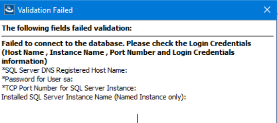

This makes sense to me, trying to work through it now.  The errors I get now are misleading:
  • It doesn't ask and shouldn't need any info about the sa account now.
  • Named instance doesn't apply
  • TCP Port number is definitely correct.
So, I think the issue is related to mapping between the servers.  (App and db.)  It's mentioned in this post:
https://community.ptc.com/t5/Windchill/Windchill-and-SQL-Server-on-Amazon-Web-Services/m-p/552533
Unfortunately, it's not quite as straightforward as they make it sound.  Amazon hides the private ip address for RDS servers.  The internet at large gives some options for tracking it down (via associated security groups) but in the same breath tells you how terrible an idea this is because the IP can and will change.
I think this is the right track though, I'll keep at it and post back here once I have a definitive solution worked out.
Just wanted to loop back around to this in case anyone stumbles upon this thread in the future.  The further issues I described above were NOT caused by server mapping issues.  In fact, if you set things up correctly when creating the RDS instance, there should be no need to add any entries to the host file for this purpose.  I errors I was getting was my own fault - because of the bouncing around I was doing trying to troubleshoot various problems while simultaneously trying to run installers I failed to realize that I had manually created the db user... but not the Windchill db itself.  Once I did that, it worked fine.
